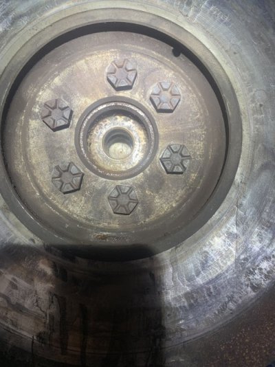

I'm needing to replace my clutch and flywheel on my 1969 RR. The car was oringinally a 383 but now has a date correct 440 in her. I'm needing an 11" disk, 143 tooth, but I can't find one that has this offset bolt pattern, see pic. All I can find are symmetrical bolt patterns. Any suggestions?
Any reason for the offset pattern? Changed mine a couple times and I also have a 143 tooth flywheel but with the symmetrical pattern. Block is a '72 440, but the crank is still forged. Not sure if it was original to the block.
