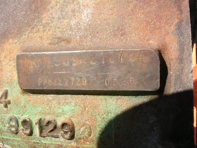

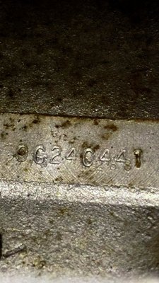

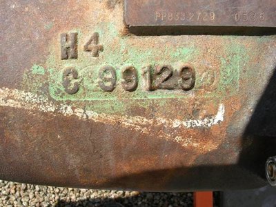

Price is ok with the shifter if its good but you are going on his word without opening it up and then it takes a trained eye. Turns free doesn't mean much, I do not have the part #s but could tell if it is a B-body with a picture. If it is originally from a 69 it will have a full VIN stamped on the side starting with RM21H or RM21H. A core without shifter is worth about $400 to a rebuilder. :yesnod:
my trans only has the last 8 of the vin; passenger side stamped pad.

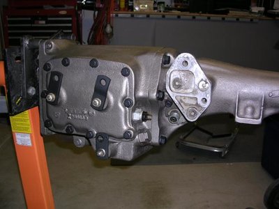

Might differ from plant to plant mine has the whole VIN. It should have a long tail shaft and the shifter mounted toward the front of the tail shaft
Jamie Passion wants $1295 for a ready to go rebuilt 23 spline. great guy to deal with. I got one from him once, traded in three cores at $200 each and picked it up at The Nats. $900 better be good to go. without knowing the seller or the history of the trans...I think I'd pass.
