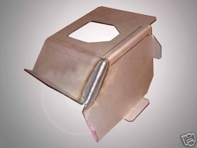

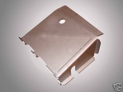

Ft and rear torque boxes along with the frame connectors listed above will keep the twisting under control.

Definitely go with the torques boxes? They installed them in the hemi's and six packs from the factory. I'd also go with the fender braces, in addition the frame connectors and the core support.

Thanks to all for the great advice. Definitely going with the torque boxes (hemi boxes) and will probably add the frame stabilizers. Going to do an engine swap and not going to mess up the 'original' 383.DSC_8748.jpg
