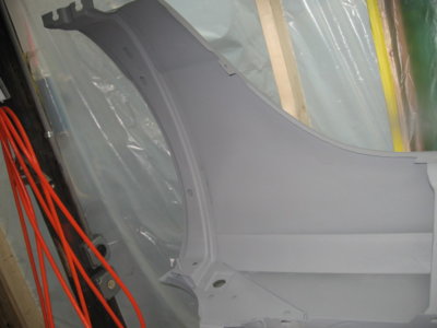

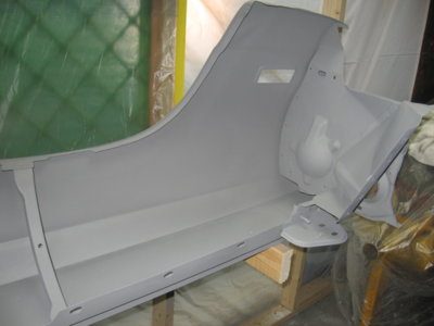

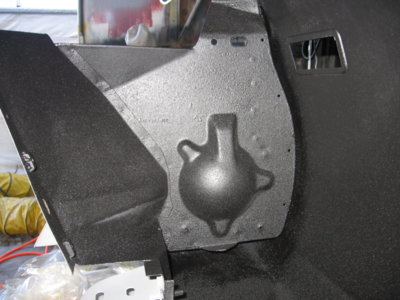

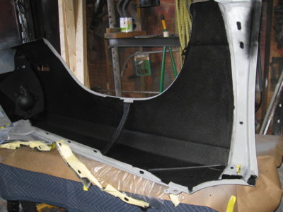

Yep primed and getting bed lined. Take a while to mask it off but well worth the time. Shot the fender with three coats of feather filler after two coats of epoxy. Sand it down then got it ready to put bed liner on. So here is some pic's. Plan on painting the rear support the color of the car. Did not bed line it.

Yes that is what my buddy keep's telling me. But after working so hard to make it rite wont bring my self to cut corners. No the bed liner is what it is. Don't want to paint over it. I whipped down with lacquer thinner that is the over spray or where it got through where I did not want it. Masked off where I did not want it. That meant rapping the whole fender.
