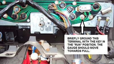

Try this(see pic).... If the gauge moves, then it's likely OK. At that point, turn the key off and gently tighten the nuts on the gauge studs (might as well do 'em all if you can get to 'em). Sometimes poor contact with the circuit board will cause these problems. A better fix is to remove the cluster and gauge nuts, & clean the copper contact area with a pencil eraser, but tightening the nuts should do it. If you still have problems, then troubleshoot the wiring and sender downstream from the cluster. Hope this helps!

grounded it doesnt move. hooked up wires to the gauge in the cluster and hooked them to a spare gauge and it works. so I am under the impression the gauge is bad (and i did clean under the nuts before typing this)biggest question is who sells repoped gauges, all I found was for rally dashes
