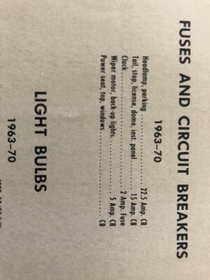

Mar 6, 2021 #1 Russ69Runner Well-Known Member Joined Aug 4, 2016 Messages 7,832 Reaction score 3,408 Location Lake Wales Fl. Looked into the service manual and see the ones that are 20 amp but cant read the other fuse size's. Need help!!!!!

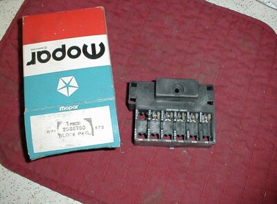

Mar 8, 2021 #2 Ernie Well-Known Member Joined Jul 14, 2019 Messages 47 Reaction score 42 Does this help?
Mar 8, 2021 #3 HD539 Well-Known Member Joined Mar 10, 2018 Messages 433 Reaction score 355 Location Pacific Northwest I think this is what you’re looking for 4 amp on left and 5 amp on far right.
