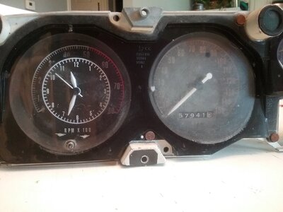

Ok guys, Dumb question time!! I picked up a rally dash for a Bee but its going into a RR, Also i pick up a tic tac toc gauge. Hers it comes, Can i spimply install the tac in the non rally dash and will work rite? and if not what do i need to do tomake it work?? Thanks Patrick

Thx, I've seen the dashes on ebay and I'm wondering what are the differances are and how hard wood it be to make the changes to make it work???

rallydash not available in 68 or 9 roadrunners. requires a completely different supporting dash frame to use. can be done but takes a lot of work.

Thx you sir, how about the 70 RR, will that work?? Does anyone a template or something of that nature that one can copy from!?!?!

Your easiest route is to get a dash frame from a charger and swap for yours. May come with dash cluster etc

ok!! well i have the dash cluster and as i type I'm swappin out the black for a tic tac toc gauge
724
70 dash frame will not have the key switch as they moved to the column. Not 100% sure but I believe the 69 SuperBee had a rally dash. That would be your best bet for a bolt in swap.
