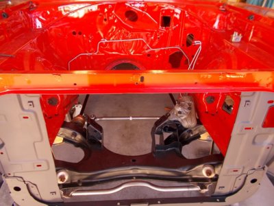

Front and rear suspension in, radiator support blacked out, gas tank in and plumbed, heater box restored and going in today with wiper arms . Working on drivers side vent, pedals and master cylinder. Goal is to get the dash in next week if the wiper motor shows up

Out working early until my hands got cold, coffee time let it warm a bit. He brought over a modern master to use ?? His car
