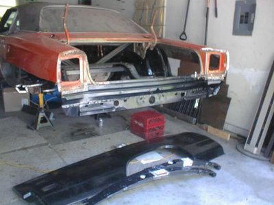

Hi everybody,
Here's an old resto pic
Ah, General Lee orange over original gold paint. I even have some RR doors with "01" on the sides. Why?

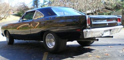

the day before The Nats, I took my road runner up to the local store to gas up. Guy came over and and said "nice car, I've got a '90 something Chevy....." I was polite like The Boss (my Mrs) tells me to, then another guy came out of the store and asked me if I was painting my car like the General Lee (my car is in primer). I yelled over "no, it;s the wrong kind of car" He got a confused look and said " well isn't that a Plymouth road runner?" I said "yes, but the General Lee is a 1969 Dodge Charger" He still looked confused but just walked away. And I agree, why? Just because we can do something doesn't mean we should. Love the big meats on the back, that looks mean!

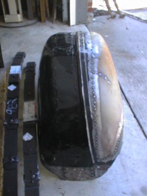

How difficult are the mini tubs? I really like the way that looks
greenpeas
Nov 3, 2014
21
Columbia, MO
If you are already doing quarters it isn't terribly bad. I say that now, ask me back then and I might have given you a different answer.
You have to cut the frame rails and install the spring relocation kits. I cut the factory tubs in half, extended them 3 1/2. I removed the portion of the factory tubs that are indented and replaced them with the donor portions that aren't indented(if that makes any sense) It's been a while since I did this.
Anyway, the result is a much larger frankentub.
