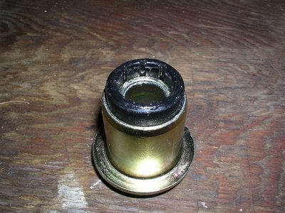

This is what I got and the rubber ones I have used in the past are assembled

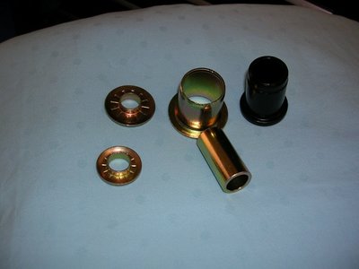

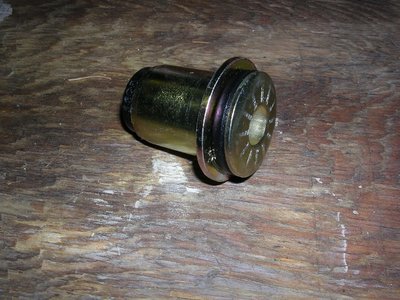

The outer sleeve is fine so on my bench I put the poly into the outer and then the inner into the poly and it causes the poly to grow in length to the point that putting the caps on looks like a no go. I tried to press the inner cap and it comes right back off the outer is fine, but look how much poly has to be compressed for the inner cap to hold?

Will it fit the mounts on the car being that long? Maybe the cap gets held in place when installing the c.a.?
The cap is supposed to press into the tube but it pops back off. I don't think they would ever go into the car that way

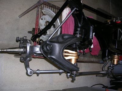

I called a couple of sources today and they told me they are leaving them apart so they get greased by the mechanic because of the complaints of squeaky bushings. I went to my local parts store and got Moog rubber ones, problem solved. I know for you purists, the upper control arm should be natural in color but they didn't clean up very well so they got the over the counter replacement black paint, its only an A-body :D
