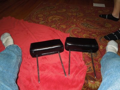

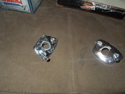

head rests is this correct for a 69 runner benchseat??
moparstuart
Feb 27, 2009
6,627

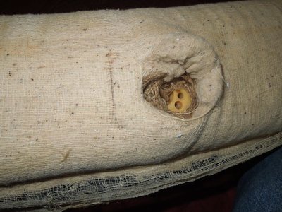

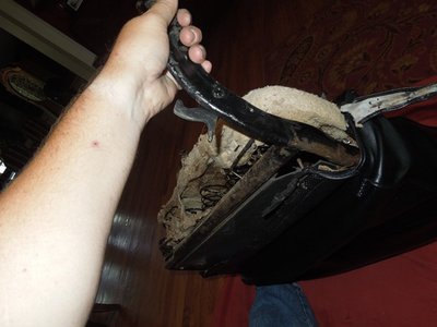

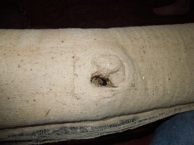

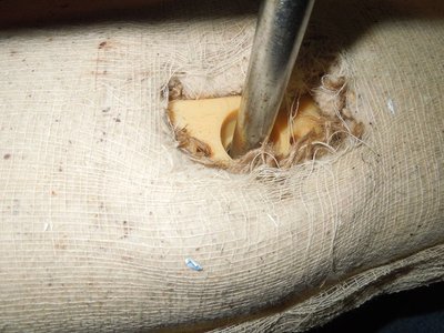

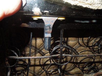

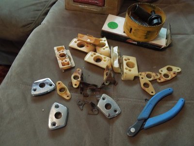

i got lucky and all the hardware inside the seat was already installed , even though this was originally a 68 bench , the seat hard ware was there for easy install
i really didnt need to take the seat apart , and pull the cover off . I will be really careful and feel around on the passenger side and just install it while in the car

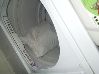

OK you lost me....what's the drywer ride for :huh:
never thought of that. when i did mine I just laid them out in the sun for a while.

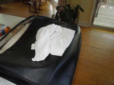

moparstuart said:
you put it in a pillow case to protect it in the dryer , the dryer heats up the seat cover so when you go to stetch it on
they are nice and soft and stretchy and slide right on
Now thats a good idea. :thumbsup:
