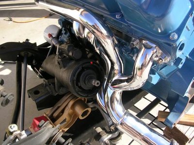

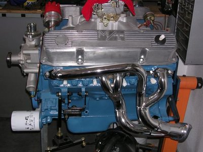

Are you talking the tri y's like this

These are Schumachers. I just looked at their site and found what you are talking about on the Z bar so never mind. I do hear good things about TTI but no first hand knowledge
