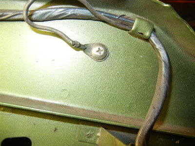

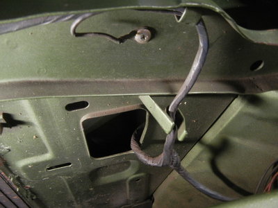

I bought some new harnesses and my painter took all mine out before I thought to look where they went. Where does the light harness go through the radiator support? Any pics?
10,540
286
ask and you shall receive!

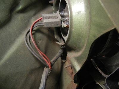

Thank you very much!!! Dumb question , but what holds the headlight in place?
724
You need a set of head lite adjuster screws. About 12 - 14 bucks. Any Mopar parts dealer will have them.
abodybill
Senior Citizen Member
Jul 25, 2010
1,610
MI. Farm
The headlight uses a stainless ring/3 screws to hold the headlight in.
The headlight bucket is heald in just as Harold said.
