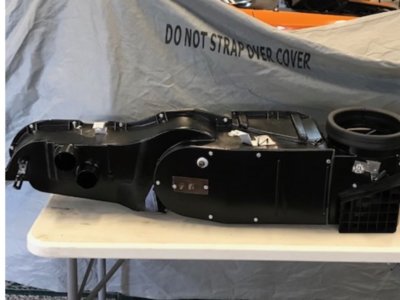

One cable works the heater to defrost, one cable is for temperature control and the third cable runs to the passenger vent.

405DCB19-B062-4794-96E6-721994A1B8CE.jpeg Thought a photo would help. Upper left (top) is where the heater/defrost cable attaches. Middle top is the temperature attachment and the far tight is the passenger fresh air vent which is part of the heater box. The passenger vent control cable attaches to the right of the steering wheel.
