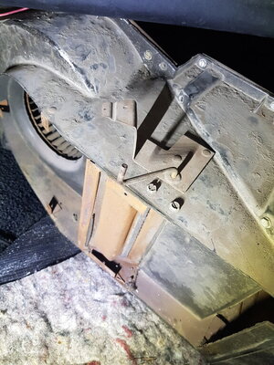

I got heater box out to replace the heater core. . And there was no cable on middle flap. How and what opens and shuts that . Thank you
13,677
830
That cable is supposed to run up to the heater control switch. Two of your three cables run there.

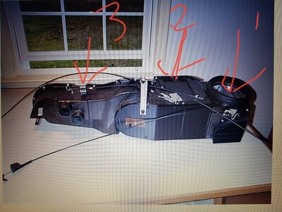

Ok i found a pic , on the net , .
My car has #1 going to control switch
#2 nothing
#3 contol switch.
But this pic tells me #1 is a stand alone scew under dashhandle thingy

Ok car heater box obversly has been out before and cables on ass about. #1 is outside vent with its own vent pull thar screws up under dash. Thats not on car
