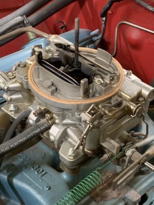

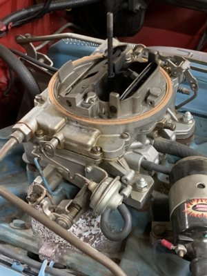

354
Pacific Northwest
I second (third?) the statement regarding the Carter carburetors. I also run the carter 4682 on my 383. I recently rebuilt it and am very happy with the result.
