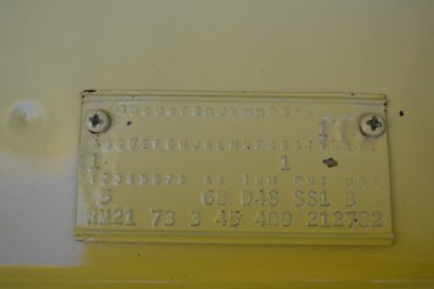

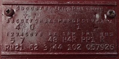

    Ok Guys....on top row of letters..what is a 4 under the C...a 0 under the F...On lower left #s what is a 5 under the 2..and a 7 under the 4.....under the TRM is H4R.....on tires what is a 44...Under the UBS...I have a R under the u ? Thanks in advance!!!

    My fender tag has a C4 option as well, and I was able to get the fender decoder to work correctly, but it registered as an unknown option. I have a hunch it means seat belt delete, since I found CO4 on a fender tag or build sheet for 69-71 is: Seat Belts - Delete All Standard. I also tried plugging in different numbers under the C, but none of them were known options.
    Here is what you get when you plug in your codes to a fender tag reader:
    CAR: Plymouth RoadRunner 2 Door Pillar Coupe
    ENGINE: 383cid 4-bbl HP V8
    TRANSMISSION: 4-Speed Manual Floor Shift
    TIRES: F70x14 Red Side Wall, Steel Belted
    BUILD DATE: January 02.
    AXLE: 3.23 Rear Axle Ratio, Sure Grip
    INTERIOR: High Trim Grade, Vinyl Split Bench Seats. Red Interior.
    PAINT: Monotone Red Paint.
    OTHER: Burgundy Metallic Upper Door Frame Color.
    MOLDINGS:
    25: Drip Rail Mouldings
    47: 'B' Pillar Mouldings (for coupe)
    ABC OPTIONS:
    C4: Unknown Option
    F0: Decor Package
    R1: AM Radio
    abc OPTIONS:
    Hope this helps!
    -Mr. Moe-par

    not positive on this but I think C4 is power drum brakes?
