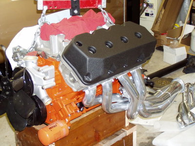

What do you know about the Mopar starters. There are 5 or 6 of them listed by tti but I couldn't find any of them. There is only one starter listed in the MPP catalog and the same part number is listed by Mancini. This starter looks a lot like one listed on ebay for $70 instead of $230 for the Mopar. I spoke to one guy who has the ebay starter and he says it has worked fine for him. I like a bargin but I don't want to fix something a year from now to save a few dollars.
I will try to attach a picture comparing the 383 to the tti headers. Hope it works.
Jack[attachment=0:2t3g9zst]P1010466.JPG[/attachment:2t3g9zst]

zupanj said:
George,
Jack[attachment=0:2f6j5avb]P1010466.JPG[/attachment:2f6j5avb]
i had a mopar starter...i think they are from a dakoda....its in my junk pile......didnt last too long....if you think its what you want and the price is what you want to pay go for it

Well to follow up I had to get a new starter from Mancini. I got a Denso and it's 1 1/2" shorter than the RobMc and it seems to fit fine. I hope it lasts a while because I don't think it will be fun to replace. Ran into a small problem with the header bolts, they are 1" long and I think they need to be 3/4" but that is an easy fix. Got the flywheel and clutch assembly put on. I hope to have it in the car this weekend. We'll see.
Here's a question. Do you use antiseize on header bolts? I think so but do remember.
Here is a pic
