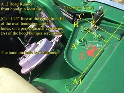

moparstuart said:
open the hood and look at the rubber bump stop
that is exactly where your hood pin should mount , it part of the fender bracket
If its for a 6 barrel hood, its on the same bracket as the hood bumper, but it doesn't replace the hood bumper. I might have a pic somewhere...
The internet connection at the motel I'm at tonight is awful.. (The joys of working on the road)... I can't post any pics from here.
Someplace, I think I have seen a good diagram of where the pin is located so you can drill the holes.
OK... back at home... you know a internet connection named Roadrunner has to be fast...
But anyway.. I got this from the A-12 site.
