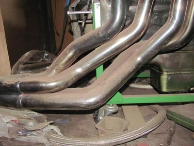

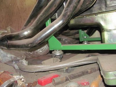

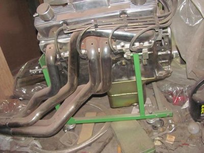

I measured the tti's that we have on a low deck (400) that's sitting in the garage on a stand. The headers hang about 7" lower than the bottom of the block. - Which just happens to be the same level as our deep oil pan.

Now I'm curious. If you're able to measure how far your headers hang down before you do the install, how do they compare with the tti measurement?

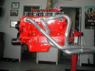

here's a picture from the ground up to the block (pan gasket hear the rear) it measures 30". From the ground up to the lowest part of the driver header is 25". On the pass side the lowest point is 24-1/2". So i's figure 5" on the driver, and 5-1/2" on the pass side.

So they actually don't hang as low as the tti's. That surprises me after what I'd read before. Even if you are measuring off an RB instead of a B, yours should still give you better ground clearance. I'm glad to know this myself for future reference.
