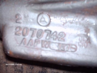

I took a look under the car yesterday to see what center section I have and it is a 742 but with the 2.32 gears and sure grip . I too am concerned about long haul highway driving but would like to have the capability for the occasional burnout . So I guess what I am asking is the 3:23 gears with sure grip capable of producing a decent burnout ?

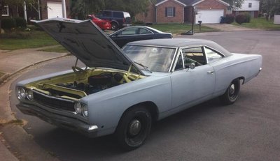

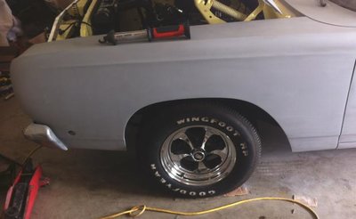

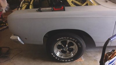

phone pics 030.jpg old look.
phone pics 035.jpgnew look!

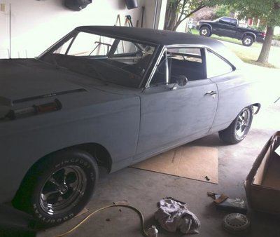

Had to lower the front a couple inches with the smaller wheels, like that look better too.
