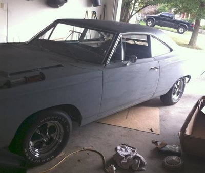

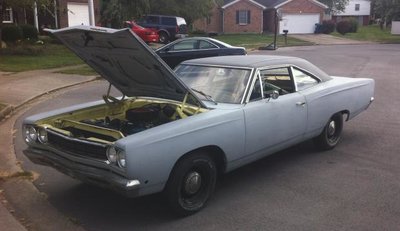

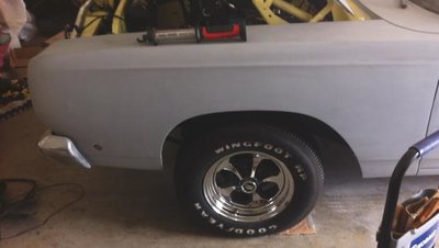

I feel like that would be taking advantage of you. Open rears are a dime a dozen, sure grips are little harder to come by. Besides once you get it out and drive it, I think you're gonna like those 3:23's. By the way just got the wheels on. They look great, I can't think you enough.
phone pics 030.jpg old look.
phone pics 035.jpgnew look!
Had to lower the front a couple inches with the smaller wheels, like that look better too.

Very nice ! glad you like them . Thank you for the pics . It just dawned on me about the open rear end and the limited slip part of the deal .
