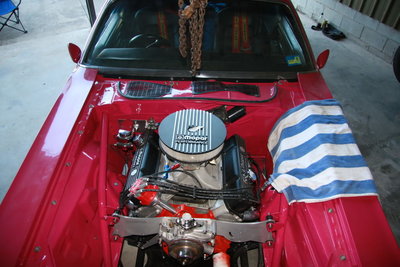

I know it's not a 69 RR but here is the my other car, when it came home to the farm it was gonna be a family cruiser but it ended up getting a little out of hand. It's a genuine big block SE car but when I got it it was that messed around with I decided to go the pro tourer route. It was completely butchered and wasn't worth saving plus it was originally burnt orange with a blue interior Yuk!

And here's what we do when we're bored on a sunday afternoon at the farm.

What are the specs on this car? Engine? Tranny?

It's a 30 thou over standard stroke 440 with six pack rods arp bolts throughout a .557 solid Mopar purple shaft cam standard out of the box edelbrock performers and a Mopar M1 intake with a BG 850 race demon sitting on top. Pretty basic set up but I built it before all these stroker kits and big heads started to become affordable. It goes ok though and managed an 11.97 the first time I ever had a go on a drag strip. It's probably got a mid eleven in it with a bit of tuning (and me learning how to drive it :lol: ) so i'm pretty happy with it. It doesn't get driven much but when it does it gets a hammering, it's just fun every now and then to jump in it and torch the tires.

Nice looking Chally! :thumbsup: And RHD to boot! Cool!!! I love RHD after my time spent in Japan...
We have those same blue & white towels out on the lanai for pool usage...but I'm not allowed to take them to the garage... :lmao:
