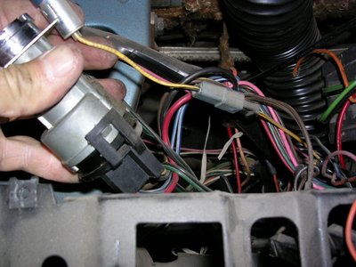

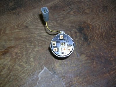

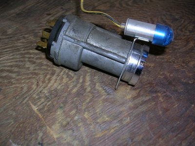

Hello to all! I've been trying to play around with my car. The fender tag states that my car came with the A01 light package but I do not have the ignition key light. I found the light that connects to the starter but really not sure what to look for next. I try to stick my head up behind the dash and the only free wire I can find is a yellow one with a black adapter piece on the end. Does anyone know on a 69 RR where the time relay would be located or what wire harness I should be looking for to connect the light? Thanks!!
This might help. The timer is all taped up to the right if the switch on my car

Thanks for the great pictures!!! Today I actually pulled the factory radio to get to my gauge cluster. I had a blank and came across a clock so I installed that today. Since I had the radio I noticed I use to have a front speaker. I went ahead and purchased one to install. The funny thing is i have a yellow cable that is just hanging behind the gauges but I can't trace it because I don't have enough head space to see up behind. I was going to plug it into the ignition light and just test to see if it would turn on when I opened the door. The cable in the picture looks just like the one I found. Ill update when I get my car back together!
