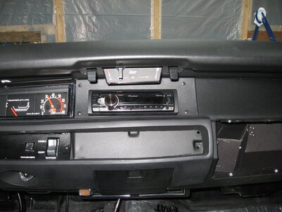

Heck I put a Pioneer CD-Radio in mine. Just bought a new bezel and cut it to fit the unit. Has blue tooth and all kind's of stuff. Like hand's free for you phone. Just to say. Maybe some one has put one of those unit's in that can help you walk through the process.

Tell you the truth that I got lucky that the CD will just have enough room to clear the AC and Heater control switches. Each to his own and out with the old and in with the new. Like that song Slow Ride by Winters Brother's with a little Bad Company. LOL. Have fun and make it like you want it. :beep:

IMG_0103.JPG Got the radio plate from Parts Mix. Cut it to fit the Pioneer radio/CD. It is straight but the dash pad makes it look off.
