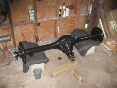

Oh thanks guy's. Just got the bearing on today broke my press trying to get the marriage ring on. Well it was home made so welded her up and finished the job. You can heat up the ring gun metal blue and it will go on easy but decided to oil axel and ring with WD 40. Whey their done. Now time to put it together. :praying:
7,705
Well here it is. Will put brake's and drums on after installing it back in the car. Bent one of the brake drum's used it as a spacer so the new lug bolts would not get messed up. Getting new Bendix drum's. Also brake lines and E brake cables. The new green bearing's went in like a charm. No issues with the axel spacer plug in the chunk .IMG_0101.JPG
