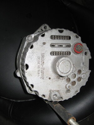

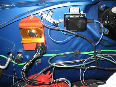

IMG_0103 (3).JPG Here is the pic's of what I have done so far. The alternator is a Delco Remy. Will have to see if I can look it up tomorrow. So I know the amp out put. It worked figured to clean it up and use it. Might save a little money. LOL. IMG_0105 (2).JPG IMG_0102 (3).JPG

View attachment 33975 Here is the pic's of what I have done so far. The alternator is a Delco Remy. Will have to see if I can look it up tomorrow. So I know the amp out put. It worked figured to clean it up and use it. Might save a little money. LOL. View attachment 33973 View attachment 33974
that is a gm alt you need a square back alt.some one did not do that right. the ign/ reg, look right the regulator looks like old style you should have a electronic reg
this is a ele, regulator
other wise all looks good

napa should be able to get the mopar alt for you and this style regulator. or has that regulator an updated electronic one ?

If you want to use the GM alternator it is internally regulated but you still need the ballast for the ignition. If you need that many amps I would go with a Powermaster Chyrysler style alternator but that's your call. I have the 95 amp powermaster on my Valiant with an external regulator it runs my A/C sound system and fans

Oh if that is a new old style regulator they are updated inside the old cover so no worries.
