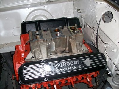

Here is an update on the heads, intake, and new valve covers after being installed. The engine is starting to look very sexy my friends. The carbs are out being cleaned and rebuilt. Hopefully I have them back soon and should have the rest of the engine parts installed by then.
