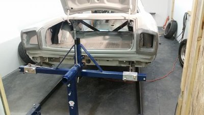

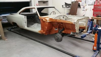

Hi all, the 69 RM23 project is moving right along. All the AMD sheet metal is in or on it's way. Getting close to painting interior parts and I've come across a dilemma. I'm not sure what the level of "gloss" should be on some interior trim parts. My car was originally, and will be again, T5 exterior and T7 interior. I know the dash is flat T7, and the interior of the doors and the trim piece below the rear quarter windows should be gloss.
But what about the steel headliner trim pieces, one each above the side windows, and one above the windshield. Should these be gloss like the exterior? Flat like the dash? Something in between? Need to know so we can order paint correctly.
Thanks in advance!
A couple teasers setting it up on the rotisserie.
