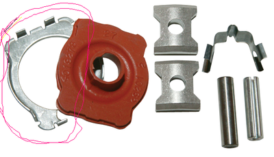

So any ideas on what happened? The steering column shaft came out of the coupler box. Am I missing something that keeps it in place?
This is what I put in several weeks ago, and I now have another one coming. The first kit came from Steer and Gear. The second is coming from Year One.
https://yearone.com/Product/DisplayProduct/82875
Has this happened to anyone else? My uncle thinks there may be something in the coupler/box itself. We sure didnt miss anything before though, and we worked right from the shop manual.

I wonder if the clip which fits over everything came off, allowing the shaft to pull out??

I don't know. I called up Steer and Gear and spoke to their tech guy. According to him, the only way possible is if the column and shoes weren't seated in the housing. I remember beating the heck out of it trying to get it seated. I needed a new kit as the seal ripped and I lost the spring clip when it came out.

After the center pin is pressed in if it even needs replaced its a matter of grease putting it together slipping it into the housing and bending the tabs. I'm not sure what your beating on :huh:

Fitting the shaft down into the housing, if I remember right.

That should be a slip fit a little tapping at best, sounds like something didn't go together right.

I remember having trouble getting mine back together when I did it on my car. IIRC it didn't go together right the first time and I had to re-do it. I think it was because I didn't get the shoe spring squeezed together around the shoes right while sliding it into the body. The other problem I had was getting the body cover crimped to the body right. That was a real pain getting the small tabs bent over to hold the cover tight to the body.

300
If this is the part you mean, no, it has nothinh to do with it. Every Power Wagon I ever had had that part halfway up the shaft at one time or another.
