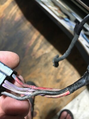

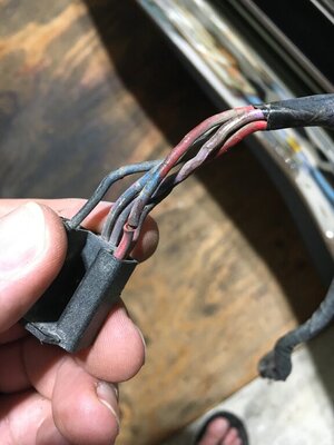

Well I think I found it. Disconnected it at the firewall and got the rear lights all to work. The front lights harness has some issues. Looks like there’s a few spots for the headlight harness for the left low beam. Then it is giving different ohms reading each time I check it. I’m sure that harness got beat up when it got hit. 0F06B88F-098D-4374-A32F-6E794BA1EF3F.jpeg945C803B-28CA-4126-9D6F-6F3BC253A145.jpeg

Their you go. That is what I thought worked before the fender bender so hence led me to believe something got messed up in that area. Blead over from wires touching or direct ground to metal. Hope this clears up the problem and you can get back to driving the car. Have fun. :thumbsup2:
