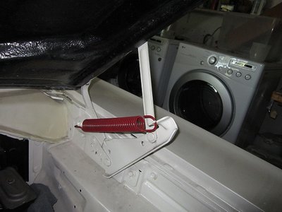

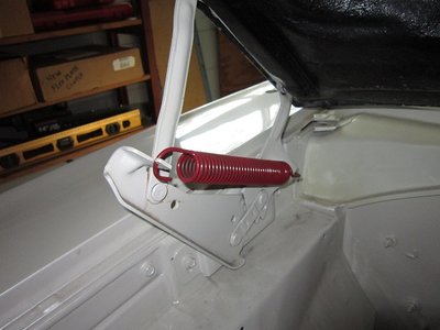

JJRJR, I did install the light weigt Challenger T/A springs on my hood. They work great, attached is a couple of pics with mine installed.
Jeff (4spd69RR)
