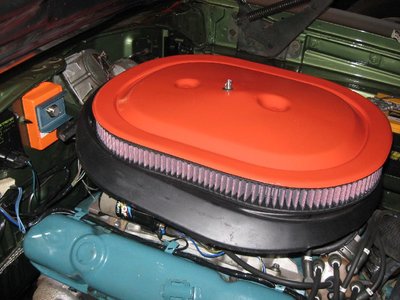

I finally got around to getting my 3 speed wiper motor fixed and installed. A local guy only charged me $30 to go thru it and fix everything. After getting it back, she hooked right up. There is nothing else needed to convert from a 2 speed to a 3 speed other than the motor and switch. The wiring is all the same. Now, I can run my big air cleaner. :banana: The base is off of a 70-up car. The top is a cheapie fiberglass unit I bought from Year One a long time ago. I just gave it a few quick coats of the spray bomb stuff. Down the road I'll get the correct top and filter element. For now, it's good enough for me.

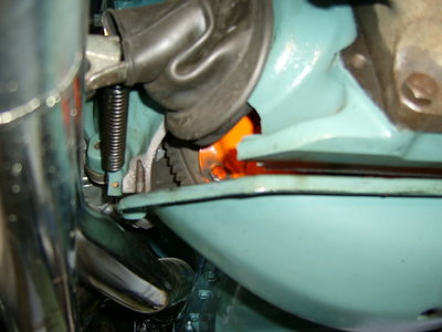

Don't mind the coolant leak......... :brickwall:

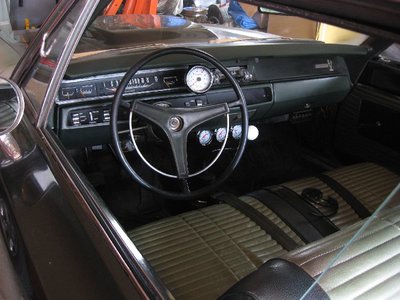

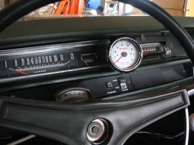

Also got my tach hooked up. Nothing fancy. Just good enough for me.

Lookin' good there Dobie. $30 to fix a wiper motor sounds good. And dosen't it feel good to be making progress and getting things done on the car?
I hate you.....how come you get a big orange air cleaner and I don't........
lookin good Steve. :cheers:
remember me "down the road" when you get the "corect" stuff. I have no problem with the "good enough for me" stuff. that usually just means it's cheaper.
"Dear Santa........."

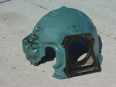

How did you approach the 4 speed swap??? Did you buy a kit or use all vintage stuff?

Thanks again. I had a lot of help in reference to the 4 speed swap from my uncle. He knew pretty much everything I had to get, and had made out a nice sized list. After that, I kept calling up Brewer's and bought things a couple hundred dollars at a time. I got lucky in that my uncle had a peddle assembly from a parts car. The hardest thing to find was a bellhousing. I could never find one at either Carlisle or the Nats. If someone had one, the price was near $700!! Finally Brewer's started stocking them, and that was my Xmas present 2 years ago. At this point, I'd still like to find an original shifter. I like the Competition Plus stuff, but I really like the originals. Definitely a shorter throw too.

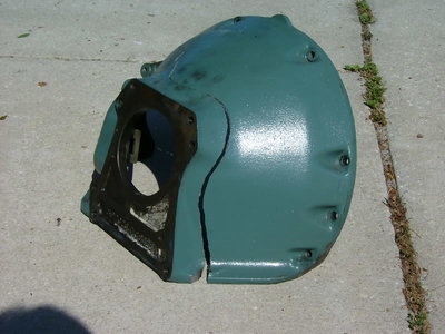

dobie....looking good....go with the blow proof bellhousing....if you do make sure you align the bell with the crank...man i sold 2 stock bellhousing on ebay last year

The car came with a blow proof housing. Due to alignment issues, and not knowing the true specs on the engine, I decided to go with a stock unit. I had called Lakewood and asked their advice on what to due. They wanted to know the measurements of the crank, which I had no clue about. Then, they asked 50 other questions I couldn't answer. In the end, it was far easier to go with a stock bellhousing. I ended up selling the blowproof one to help pay for the stock one.

when i did the first engine in my car....383....in the boxes was a lakewood bell.....did the dial indicator trick to set it up and worked fine....then having all that fun bang shifting...blowing up 3... 883 trannys i went 727 and now color me gone....john cope racing trans....good for 1200hp.....he is the man
