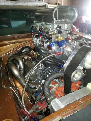

That burn is on the blanket itself and a main reason for fender exit headers.I have the headers off welding tube tabs on for the collector to bolt to but I have last months pis of it all together.

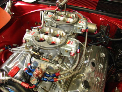

hows that carb linkage working for ya......i dont give a shit what i did......the gas pedal was always tuff flooring it until i went with 2 throttle cables to the gas pedal.and to the carbs......man did that work like a charm
holy crap howinna hell do you see past that!!

Ya it is hard!How the heck did you run 2 cables?I don't mind it being hard as long as it works.

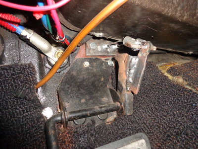

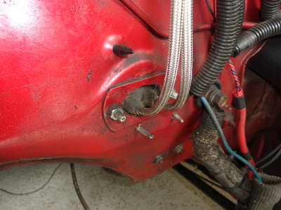

i made a small plate for the 2 cables to mount to behind the firewall by the gas pedal.....then ran each cable to each dominator......i will take some pics tomorrow and post them so you can see what i did

dual throttle pics[attachment=1:20akzutc]DSC00239.JPG[/attachment:20akzutc][attachment=0]DSC00241.JPG
yeah....theres enough weld on there.... :lmao:
knowing what was on the other end of those cables....that 's not the time to be cheap on the welds.... :eek:
