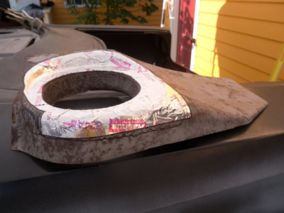

Since both patches are complicated shapes, I have to get creative about what method I will use to make the piece fit the car right. I decided to use aluminum tape to create a template, using the duct hole as the reference point. Here is the template placed on the area I will be putting on the car:

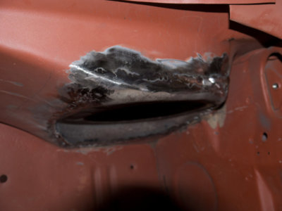

Then here it is transferred to the existing lower cowl panel and outlined in sharpie:
I then can cut both pieces and in theory, they should fit perfect. Well, they sort of did. It was close enough that I was able to continue with not much extra work and I got the cowl patches welded in to place. You almost cannot tell it was repaired!
