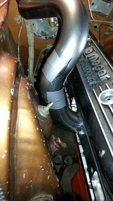

Well I am at a stall with making progress because I got the wrong gauge pipe to finish so untel I exchange it this week I guess I could ride the motorcycle on this 60* day in March.
Thanks again!I have yo make a couple of slip yubes for thatr side and I am going to start on the passinger side exit.
I sent what I had to the welder and will finish when it comes back.I am having problems with the passenger side exit to make a collector.The slow pke welder will be done in 2wks with what I gave him.

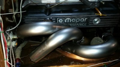

I got my pocket picked by that welder so I took my money to another welder.here is what I got done.
I can start working on the exit and collector on this side while the other is getting done.
I did that once, never again :crazy: What kind of coating are you going to use on them ?
I have done tech line coatings cermacrome before but for now I will likely use BBQ grill paint or Red Hot aluminum color paint.[1300*F]

He won't do it again to anyone I know if I can help it.I am working on the driver side collector today and hope to make some progress on a mockup head finish welding it.
