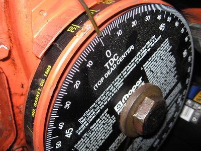

well i degreed my cam today and got the results i was sorta hoping for. first getting ready
then setting up for TDC on #1

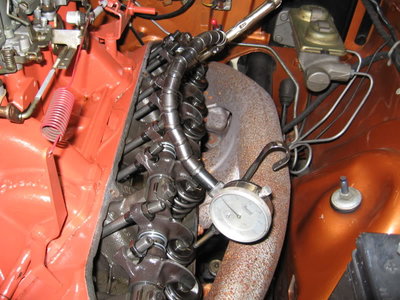

setting up the dial indicator

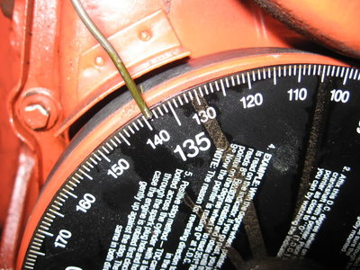

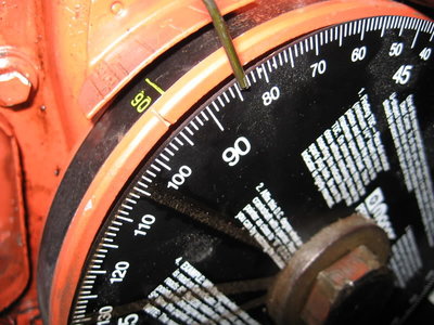

getting my degree readings before and after max lift
doing the math 84+140=224/2=112. the card for the lunati cam says it should be insatlled at 106. i think 6 degrees is enough to cause some issues. now i still have to make a choice to reinstall the current cam or go for the mr six pack cam but at least i got some results that do some explaining of the tuning problems i have experienced.

Did you use a TDC finder (piston stop) to ascertain true TDC? The picture has an angle that makes it hard to get the proper perspective - but it looks like the pointer is in line with your timing tape... If you didn't, get one and use it. Don't rely on the harmonic balancer...the outer ring can be off a tad...especially if it's a 40 yr old original...

i did use a piston stop while finding TDC and was very happy to that it lined up with the timing tape mark. the finding of the cam center line was done 2 times with the exact same results. i do agree with minimal effort to reset the cam in the car will be the way i am going. so it is off the garage.

Where did you score that crazy flexible dial indicator mount? I WANT ONE OF THOSE!

that's a piece i borrowed from work made by KD Tools

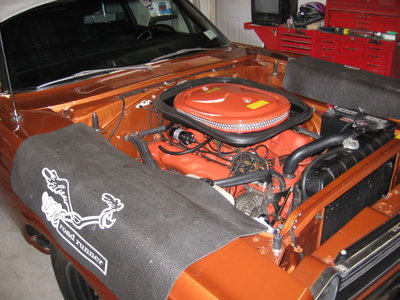

no. i head down with 2 friends and a 24 foot trailer loaded with mopar goodies to sell in the vendors area. but i won't say never. maybe someday i will have all the bugs out and make the trip. i am trying to get my one buddies car ready to go for the lift off hood reunion.

that's rick from the lift off hood forum (f6bee), one of the mods over there. ever since the body has been done he was sorta afraid to touch the car (didn't want to scratch it), but once he got over that has has been going gang busters on it. he is the guy that had a post on cleaning the drive shaft with evaporust in a pvc tube. rick and i are part of the trio that goes to carlisle evry year. car is f6 bee with black interior and black butt stripe with side scoops. car will be amazing when done. the paint and body work are super clean.
