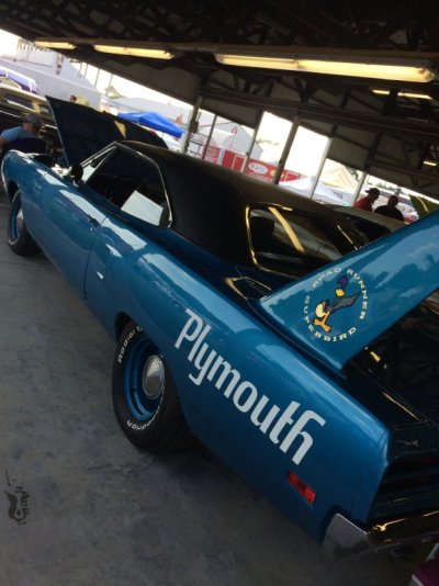

Oct 24, 2024 #5 6PKRTSE Well-Known Member Joined Oct 1, 2018 Messages 305 Reaction score 340 Location Motor City 4-1/2" b.s. and you will be fine. I have 6 sets of wheels and tires all with the same combo on several of my B Bodies.
