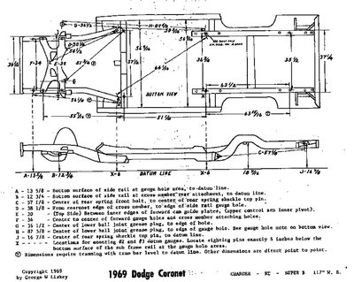

i have a frame chart i will try to post and maybe you can use some of the info.
