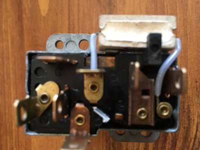

I've looked through the threads but still can't find an answer to my question so here goes:
Somebody swapped a 3 speed motor into the car before I got it but kept the 2 speed switch. The wipers are not working so I'm working on this blind. I picked up a 3 speed switch because I figure that needed changed either way and it has 2 additional spades than the 2 speed switch does. can anybody tell me what these 2 spades are? The spades I'm referring to is the one on the very bottom and the one on the far right. If I know what they are supposed to go to, I can run the additional wires, but I'd like to do it right the first time.

Hey John, I have a 7th spade at the bottom of the switch that is designated resistence cable. In the diagrams it show a wire from this spade to one of the others on the switch but I can't tell which one it goes to
The resistor is already on the side of the switch. See the white ceramic block?
attachment.php
I have no idea why they have an extra spade there. My best guess is the switch also fits something else and that's there to ground the case or something like that.
