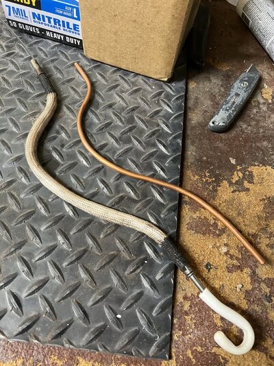

Just put one on my hemi with headers
What a pain that was
Got the one with the Kevlar insulated wrap
I took a piece of copper tubing and bent it to fit then used it for a template for the new one then I had to take a file to the stick to it with slide through the curves I put in it, even had to file the lettering down because it was raised from stamping and would drag but it works great now
