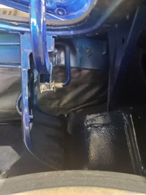

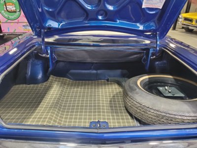

RonLiv has vert. may be he has some pic's to help ya. May try to PM him. Hope that he has what you are looking for. :thumbsup2: Go to Ron's photo Garage their is a picture of the trunk while it was in restoration. May be that will help.
I'll take one today and send. If you send a pic of exactly what you want that would help so I don't take the wrong shot.

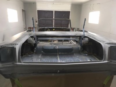

Digging through some of the restoration pictures I found this one. I'm still going to take some pictures this afternoon. 15823128_1713490655629934_7346379577941141939_n[1][2].jpg

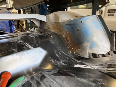

Here's what I took. If you need more or a different angle let me know.

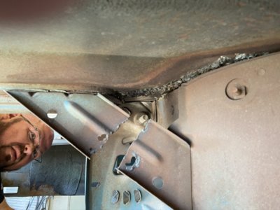

Thank you Ron. As I thought a dent in mine that shouldn’t be there. I had old light collision damage at the bottom but never noticed this402F678C-DCD8-4738-BAAF-D3431AECD066.jpeg

The guy in the picture is a sheet metal expert. He is the one doing the work. Body assembly should be done over the next 3-4 weeks. The cut brace was the last of the poor quarter panel repair previously done years ago that needs fixed right.
