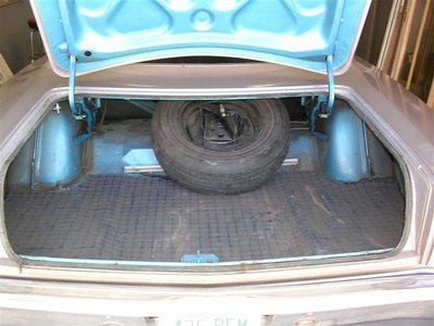

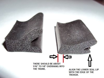

22,146
2,356
Re: Need info on how to install trunk and hood weather strip
nicanor said:
Please verify,
The trunk seal goes in the groove? Not at the edge of the trunk. I thought the grove was a rain runoff. So please let me know if the weatherstrip/seal goes in the groove. That would make sense.
Thanks for the help,
Barry
It goes on the edge, water runs down the groove.
Just what the picture man said and can't go wrong :thumbsup: :D

Does the "V" in the weatherstrip/seal split the metal edge or does the complete seal sit on top of the ledge? The picture looks like the seal is splitting the edge.
Thanks,
Barry

Thank you for the pictures and suggestions. Does someone have the website address for Dixie?
The one on the right is the Dixie seal. The one on the left is the one most vendors sell. I don't recall the manufacturer's name off hand. The Dixie one matches the O.E. seal perfectly. Black weatherstrip adhesive is the way to go. I use those office-style (legal?) paper clips...You can get 'em at Staples. Get a bunch. Cut up some cardboard into 2" squares and place the clamps (clips, whatever they are) next to each other with the cardboard between the seal & the clamp. That way you wont leave an impression of the clamp in the seal when you remove them. You can do a couple feet at a time. Make sure you adjust the trunk striker/latch and get eveything lined up good before you do this. When done, shut the trunk for a day or two.
