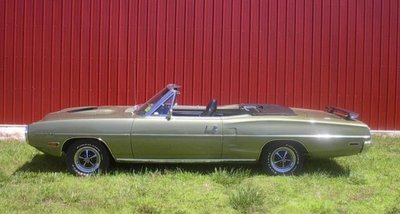

Have a recently purchased 1970 RR Convertible. Plan on adding power windows (can't have a convertible with manual windows...LOL) Wondering if anyone could post a couple photos of how the power window harnesses are run on and inside the front doors and the rear interior quarter panels and where the switches are placed on the interior door panels. Mopar shop manual does not show anything.

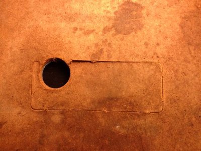

Do you still need photos of where the switches go? They're in the same location as the hand cranks. Here is a panel with the perforated cut-out. They're sized according to the switch:

That answers the question about the driver's door panel switch location.........that's good....looks like the 4 gang switch will cover the hand crank hole on the driver's side........what about the passenger side?........the single switch is a lot smaller, assume the cutout is smaller also? As for the rear panels, they are plastic.......any idea how that works?
