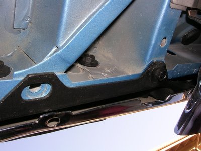

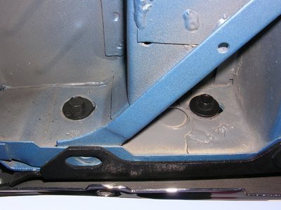

Rear bumper. Note my car had no evidence of having a second bottom bolt from the bracket to frame and it had never been touched according to the original owner, also the book does not show a nut and bolt set to go there either, so it went back together the same way.

We had to install a new crossmember for the rear and it doesn't have the weld in nuts. Do I just wing it and put a nut on a bolt?
22,148
2,358
If you can get your fingers in there. Who looks under there anyway :lol: But then again the nuts are welded to the brakets anyway, easy to do
I found that interesting as well... None of my B-bodies had a bolt installed there either. I went to a salvage yard years ago and found a '68 Coronet 4-door with a trailer hitch that bolted right up to the factory holes including that one.
Maybe it was there for a trailer hitch? :huh:
22,148
2,358
Could be, would a bumperett tie into that ?
I don't think so. The bumpers I had on Freebird had those, and there still wasn't anything in that hole.
22,148
2,358
Maybe the Dodge side of the house used them :huh:
