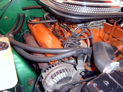

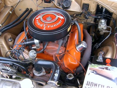

Anybody have any pic's? The length just seems long. I was also told that that the proper mounting used a waterpump bolt. Just want to get it right.

Bill is correct. Here are a couple of survivor pics I took at Carlisle a couple years ago. Sometimes there's a star washer and sometimes not. If you look carefully at the A12 pic, you can see the star washer under the bolt head. I would assume that the star washer would serve its purpose better between the cable end and the manifold... regardless, the end of the cable is always (there's that word again) between the bracket and the intake. :thumbsup:
