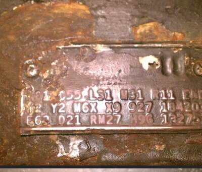

Hi, new member. I have a 69 convertible. It has a couple of options that I don’t see on the fender tag and I am trying to determine if the car came with the dana 60 and power windows that it currently has. It has matching 383 and 4 speed tranny. I am still searching for a build sheet.

I am having trouble figuring out the first 01
And the 927. The rest I have as black buckets, belt moulding, am radio, sunfire yellow, black interior door tops, 383 4 speed. Thanks

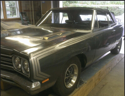

Welcome to the site. Some of the other guy's can help with the fender tag. Their is a decoder site also. :welcome: Give us some more pic's of the car. We love Pic's.
I believe 927 is September 27th and a dana 60 would be unlikely. You might be able to find some part numbers and dates on the passenger side axle tube near the center section of the dana facing the rear bumper.

Thanks for the pic. The body dose not look too bad. Look's like some rear rocker rot. On the drive's side. That seems to be normal for these car's. Good find it look's good over all.
Looks like (and based on placement) "A01". Light Package. This would include:
A01 – Light Package 1969 Road Runner
Ashtray Light (L15)
Glove Box Light (L11)
Trunk Light (L25)
Ignition Light with Time Delay (L65)
Map Light (L05)
Fender Mounted Turn Signal Indicators (L31)
Agree with Hemibeep - Dana 60 in a 383 car is a big "no"...

Dana 60 not available with a 383. No axle codes on the tag. A31 A36
No power windows on the fender tag and there would be a P37 on there if it came new with them. So it was added to your car.
