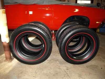

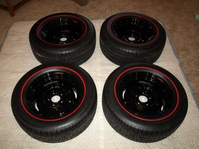

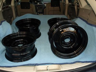

Well just got my new tires mounted up on my freshly powder coated wheels and thought I'd share a few pics..... I'm happy with how they turned out, glad I ended up picking Gloss.... and cant wait to get them on the car after I detail some of the suspension components.....

Very nice indeed....they have a nice dish what size are u running , and what type.....dont wont much do I...cheers andy

Wheels are 15x8 rear with 255/60s. The are old Power Waggon H-Wheels....
Front are 15x7 (4" BS) from Wheel Vintiques with 235/60s.
I had 15x6.5 (BS close 4.5") with 245/60 on the front previously that werent a matching set and they would rub a little, so I decided to take a chance on Wheel Vintiques and Im pretty happy with them. Less Back spacing and a little less tire width should move the wheel out a bit and eliminate the rub I use to have at full cut.
