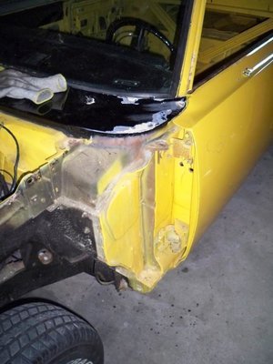

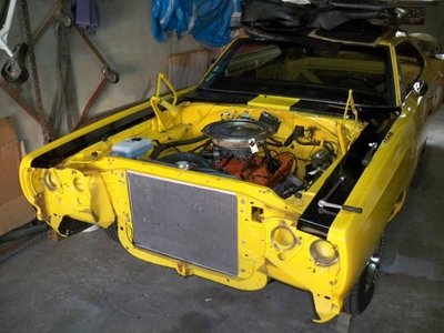

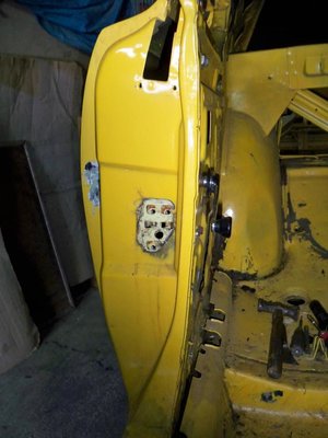

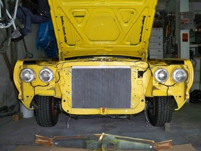

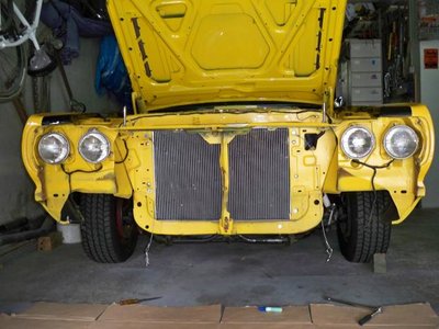

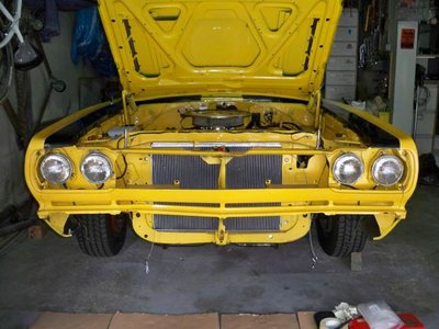

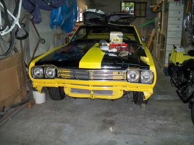

here are the first pics of the car after a quick disassembling! next will come!hope you'll enjoy it!

Suggest Get some fender covers so won't scratch up the fenders with the tools you have laying on them. :cents:
Looks like a good start so far what is your final plan for the bird?

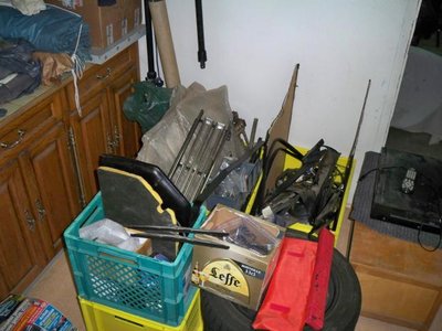

Tag and bag.
Tag and bag.
Tag and bag.
Keep all the parts in one place.

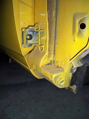

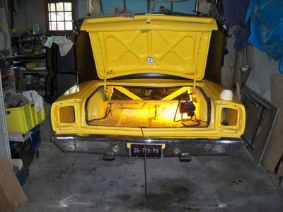

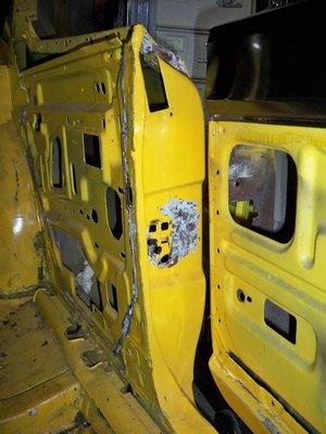

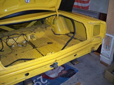

Don't worrie for the fenders cause we got to change the left one. On pics cars looks on good shape but when you dig in it, it is a mess! Except for the floors you're right they look pretty good. But we've got to change the entire end of the car, trunk floor, quarter panel, deck lick... We perhaps also need to change the left side door jamb.
But it'll be a nice project.
When we pull apart the entire car we will sand blast it! So we will be able to do a great job :) at least we hope so lol!
For the car we'd like to go with some up grade for the chassis. Like tubular upper control arm in the front, with some qa1 shocks front and rear, a new big sway bar, replace the bench seat with two buckets, perhaps a new k-member, and a 496 stroker kit. That would great! :)
And convert the front drum brakes by six pistons disc brakes, especially if we will do a 496 stroker.
I'll with more pics of problems that we get! :)

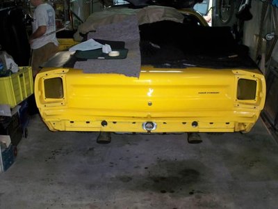

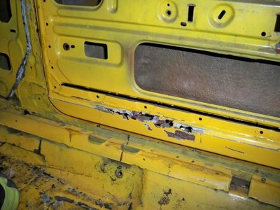

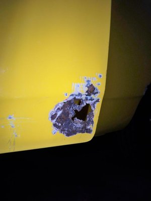

You're totaly right about the paint, back in sixtynine she came out with the yellow sunfire. But a few years eralier she has been completly restored and repainted in a way that is totaly wrong!!!!!!!
So that is why we pulling her apart and we've got a lot of surprises!!!! Like brand new rear quarter panel and new trunk floor but they have been totaly messed up by those who did that car! They have welded the new quarters on the hold ones, they cut the hold one a little bit but not enough so they welded it like that. The trunk floor exactly the same thing happened!
They made big holes when they welded cause the floor trunk was to far away from the chassis! And on the front fenders and the left door they blocked the holes with mastic! (I don't know if you say mastic in english but i hope you will understand what i mean)
So anyway we've got a lot of work to do...

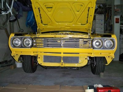

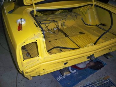

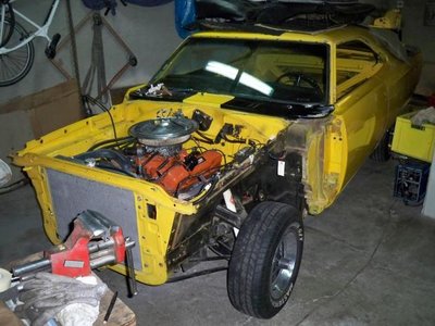

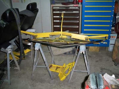

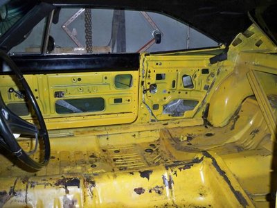

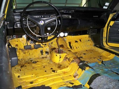

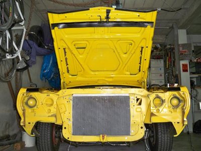

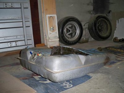

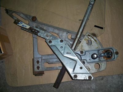

New pics of the disassemnling! :)
Most of the holes that you're gonna see were blocked with mastic!
What is down : fenders, windshiel, every windows, dash bord, heater box, gas tank, exhaust and all stuff on doors like handles and locks...

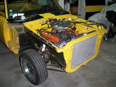

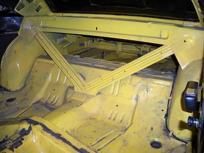

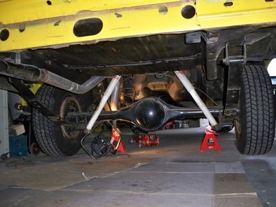

I have question of concern. Is that expanded foam I see in the fourth picture (4701) at inner wheel house bottom?
Sixtynine_Bird
Nov 30, 2014
654
125
France
Thanks we will for sure! We'll start by the back of the car and then we'll move forward slowly. But we have to wait to sand blast the car to be able to order what we really need for sheet metal.
And absolutely! it is some expanded foam that you see in that picture.
quikbird
3,233
1,028
Sarasota, florida
Uh oh, if someone tried to use that stuff who knows what is hiding in the corners, be very thorough in your disassembly. I don't know if they have these people where you live but there are some soda blast companies that will come to you and strip the car in your driveway. :beep:
