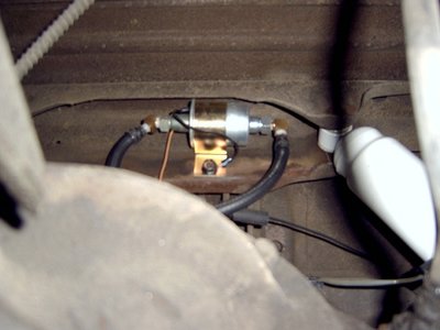

No regulator, just a 5-6 psi unit that I picked up at NAPA. There are a few suppliers out there; Delco, Bosch, among others...They run around $50-$75. Very simple to hook up & hide. Mine is above the rear axle on the shock crossmember. It's on all the time (with the key in "run") but pumps only as needed. I have it wired to the "run" circuit on the back of the fuse box. Ran a fused black 10g wire along the left side rear wire harness under the threshold plate to the back of the car. Poked a hole in one of the smaller trunk pan plastic plugs (by the spare tire) and ran it to the pump. After a long sit, I just turn on the key and let the pump run a bit - maybe 10-15 secs - pump the gas 2-3 times and she fires right up. The stock pump is still there and entirely functional. My "hot soak" issues were cured with a carb insulator & exhaust block offs in the intake gasket. These are all relatively "stealth" mods BTW.

Carter electric pump mounted above the rear axle and no mechanical pump for my car and it starts no problem every time. :thumbsup:
A31PKG
Apr 28, 2010
880
6
Mid-Atlantic
Yeah, just checked mine - it's a Carter also (couldn't remember at work today). The part # is P74029. Here's a pic of it installed:

I found your pump on Summit but it doesn't show the psi, I don't think you would want it much above 4psi if you keep the mechanical pump. Is it OK to mount the pump higher than the fuel tank?
